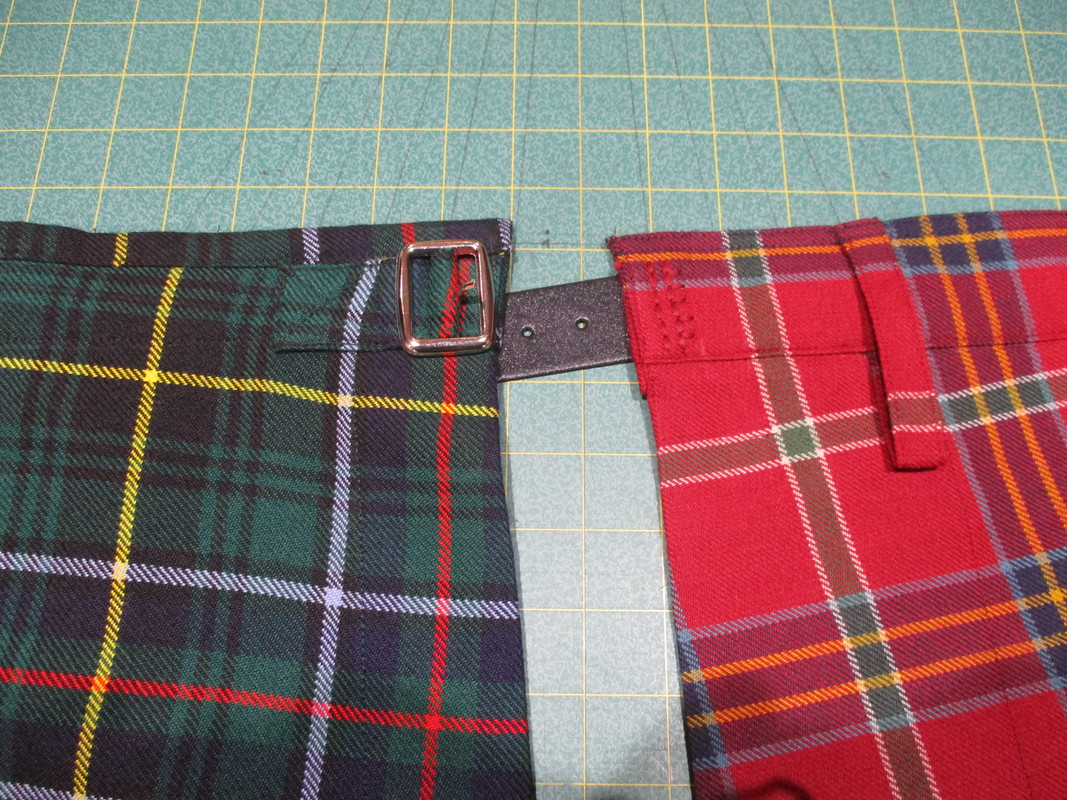

    I'm moving past the x kilt, and am looking for the reasons both structural and draping, for sewing the front apron into the left hand fell instead of letting it hang from the waistband only. Can anyone explain it to me? I asked else where and the discussion derailed into inner support and fabric choices. 'It's traditional ' isn't the answer I'm looking for.

    As I tried to explain to you over on the facebook page -
    The secret to how a kilt hangs and swishes is due to how it is constructed. The way that a kilt is constructed is different from the way the X Kilt and blue jeans are constructed.
    In a kilt the outer apron is not just a flap hanging down in the front. In a kilt, the fabric is not hung from the waistband.
    But if you wish to sew a garment built with the methods of construction of blue jeans, or the X Kilts then there is nothing stopping you from doing so. There is no rule that says you can't.
    You will not have the internal strength across the front apron that a kilt has. The front apron will probably gape open, away from the Fell, and you will more than likely have puckers and distortion of the apron fabric, but for some that is not an issue.
    You just change the construction and create a waistband like is used in trousers Hanging the pleats from this waistband would allow a garment to be constructed, as described without sewing the apron to the Fell.
