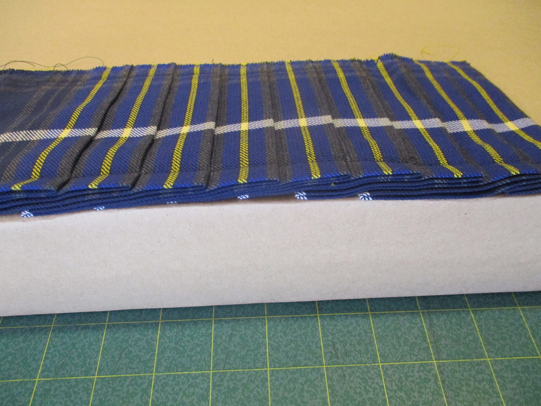

    From the end box pleats look like this -
    Each pleat is three layers thick.
    A Knife pleated kilt may have many layers. It depends on the size of the Tartan Sett and the width of each pleat.

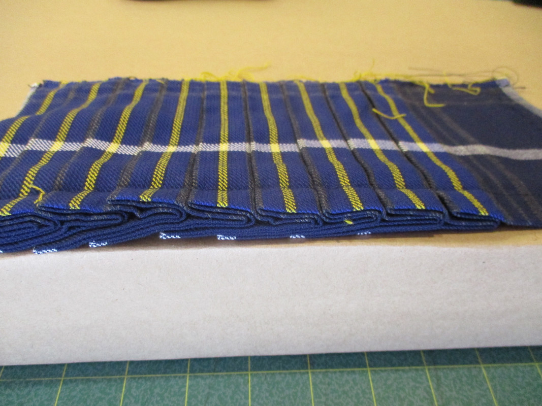

    In the above two photos, both are pleated to the yellow stripe. So each pleat uses the same amount of fabric. One Tartan Sett.

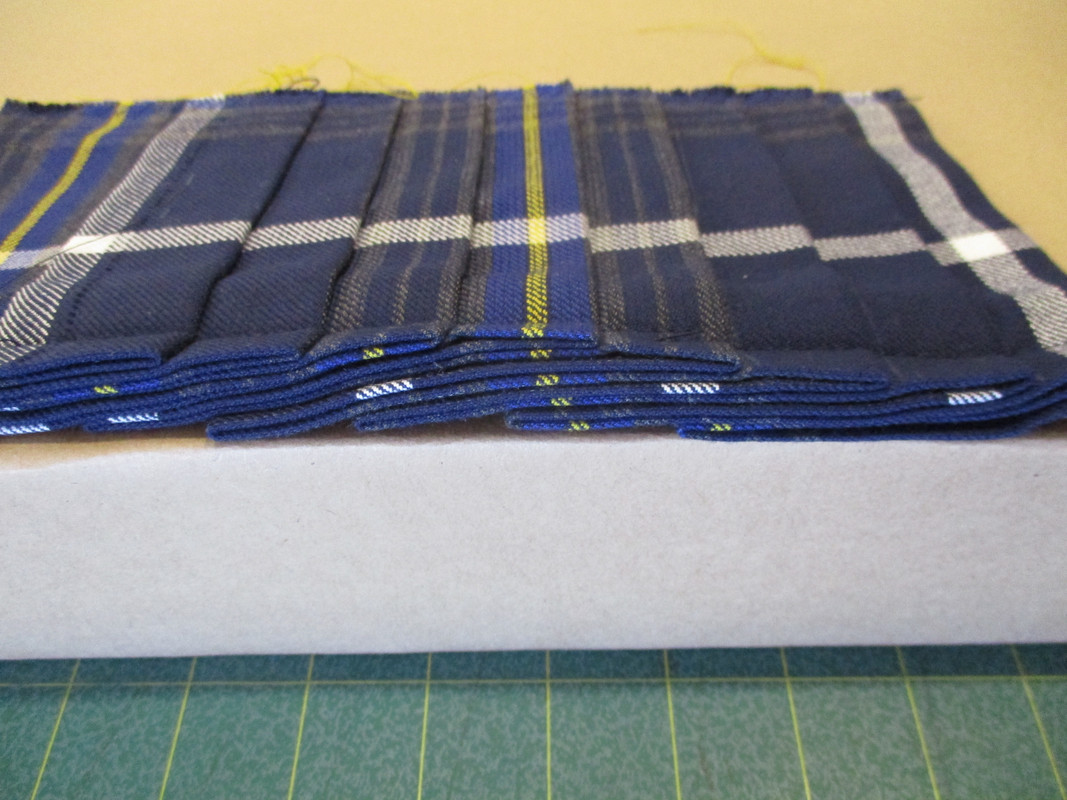

    If we pleat to Sett where the Tartan pattern is retained this may also effect how much fabric is needed as each pleat used one full Sett plus the width of the next pleat.

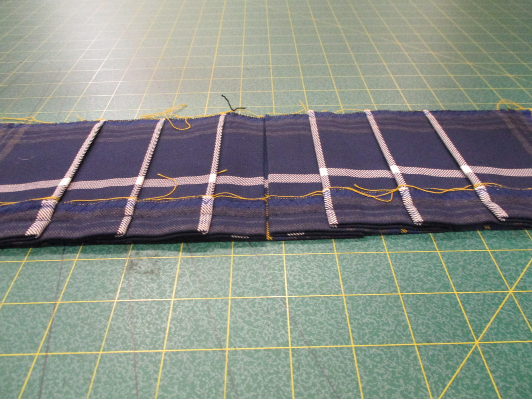

    The width of each individual pleat can also effect the amount of fabric used. Here is the same pleating to stripe as the second photo above but now each pleat is wider.
