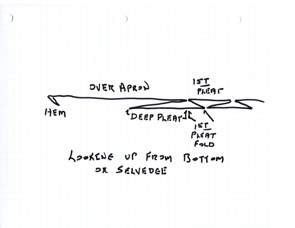

    I am finally started on my X-kilt and have a question. The Appendix 1 diagram shows, from the right hand side, an over-apron edge hem allowance; the over apron of 10"; then the under apron pleat 12" the the inner fold etc. Steve's excellent (and often entertaining) instructions direct me to measure the over apron, (which in my case turns out to be 8" instead of 10") but do not explain where the 12" under apron pleat comes in. Is the 12" is just a random measurement? What am I missing here? I don't want to start sewing in pleats until I know I am not going to regret it.

    I'm not exactly sure which diagram you are referring to but I believe that the 12 inches you are referring to is the deep and/or reverse pleats. Is it possible that the 12" is folded into a pleat so its depth is 6" after folding.

    The diagram in question
    Let me see if I can attach the diagram

    The line marked "stitch this all the way to the waistband" is folded over to the edge of the first pleat.
    This creates the underfold of the first pleat (the 3" labeled on the diagram) plus the 12" folded in half for a 6" deep pleat.

    Ah ha. Yes. Of course. Thank you, Steve. Now I get it. And of course now it looks so simple I wonder why I didn't get right away. This is one of the reasons why I have enjoyed sewing since I took it up a couple winters ago. It is much like boat building, which I also enjoy. Very multi dimensional with each component interacting with all others.
