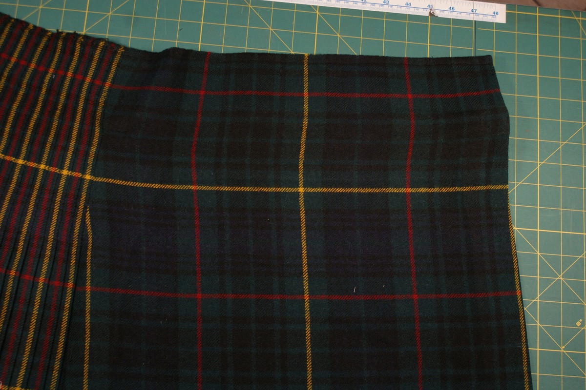

    The aprons are merely large pieces of flat fabric and they're cut to an inverted "V" taper.
    Elsie did this cut by eye, and shockingly quickly. (Though it wasn't as scary as watching her grab 4 yards of double-width tartan and tear it in two.) The cut of the fringed edge of the front apron is not a straight line, but a rather complex compound curve.
    The amazing thing about kilts is how the pleats are all absolutely straight below the fell, yet the apron taper gives the illusion that the entire kilt has a taper to it.

    As a kilt maker perhaps I can help.
    This model illustrates the components of a kilt.
    Beginning at the top is the Rise. This is the portion of the kilt above the top strap. On a Traditionally made kilt, designed to fit at full waist height, the Rise tapers outward to fit over the bottom of the ribs. The smallest part of the kilt is at the top strap.
    On many kilts made today, and all of the import kilts, there is no reverse taper to the Rise. The smallest part of the kilt is at the top band.
    In the front are the two aprons. The under and outer aprons. Both should be tapered so that at the waist, the width is just over 1/2 of the waist circumference. At the hips, the width should be just less than 1/2 of the hip circumference. And these two widths are joined by a gentle "S" curve ending at the bottom edge close to a 90-degree angle.
    On some kilts for guys with a large difference between the hips and the waist (or has a pronounced belly) his curve may be quite pronounced.
    This is perhaps one of the most challenging aspects of kiltmaking as the idea is that the edges of the apron should fall straight down from the largest part of the belly and the outer edges about where the side seams of a pair of trousers would be.
    If the apron taper is constructed incorrectly the apron edges may jut forward or open up a gap in the pleat spacing.
    The idea is that the aprons should fall straight down from the largest part of the body in front. Without puckers or distortion. The sides should not stick out sideways like a ballet tutu while gently curving around the wearers' legs.
    In the back of the kilt, from the bottom of the Rise, to the level of the widest part of the hips and buttocks is The Fell Area. This is where all the tailoring of a kilt is done.
    Everyone is larger in the butt than at the waist. Even those with a large belly have a difference between the hips and the waist.
    The pleats above the hip line are tapered. This taper is usually small in each individual pleat but combined they make up the total difference between hips and waist.
    I am sure there are some kilts where all the taper is done in one or two pleats but this would not be the norm.
    Below the bottom of the Fell Area the pleats should hang straight down, parallel, without large shower curtain folds or spreading outward in an "A" line skirt shape.
    The success of the pleats is partly due to the care in laying out the pleats by the maker.
    But mostly good looking pleats are due to the accuracy when pressing the pleats. The back of the kilt should appear as one single curve and from just a few feet away the individual pleats should not be apparent.
