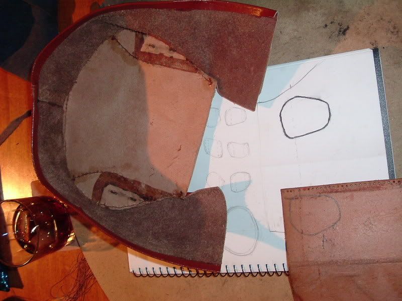

    Many thanks guys, glad you're all along for the ride. Mike that was a good affirmation of the process. Had the same design in mind with the gusseting. Found a suitable weight piece for that, but have to cut it down the middle length-wise as it's wide but not long enough. also it's a bit shinier and slightly darker than the satin/matt finnish of the front/back. I hit it with a no 6 brass suede brush to dull it a little, tho still not quite up to the same patina. the test piece frayed if I went too hard with the brush. also I'm not too sure about the staining. Put a bevelled edge on the flap and front secondary pieces (see pic). The finish is quite sealed so I was of course gonna use test pieces to get the right finish. The front secondary bits are to cover the marks left from the original clasps.
    E.

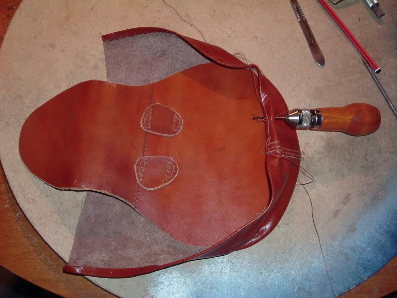

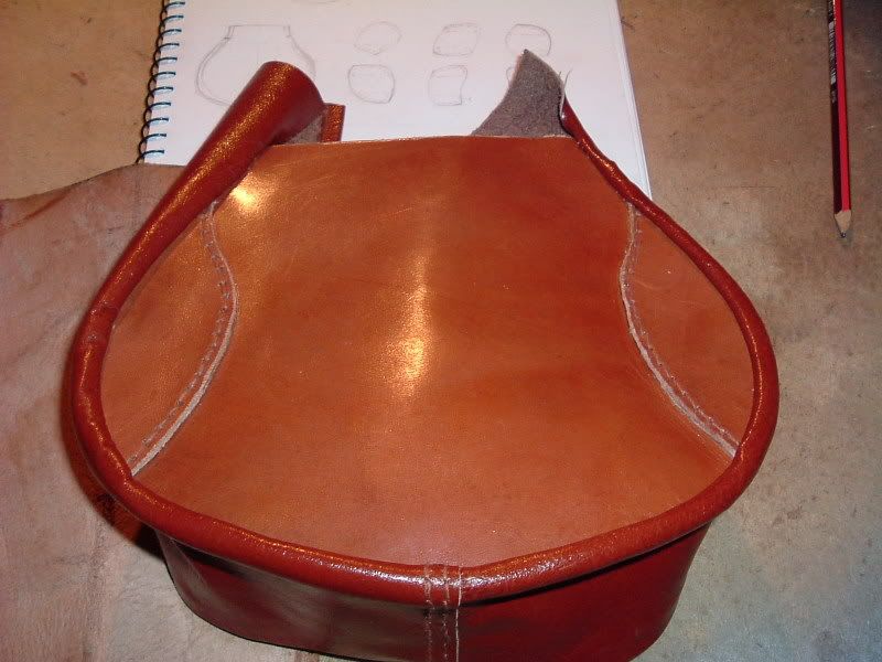

    Haven't put the awl thru myself yet...Here's the inside of front piece and gusset stitched:
    and the sexy outsde front piece:
    Belt loops stitched (glad there hidden on the back really. )and the start of the final gusset stitching. Now this bit is getting tricky to keep even. Any hints folks?Freelander? It's no bin bag but it'll have to do!
