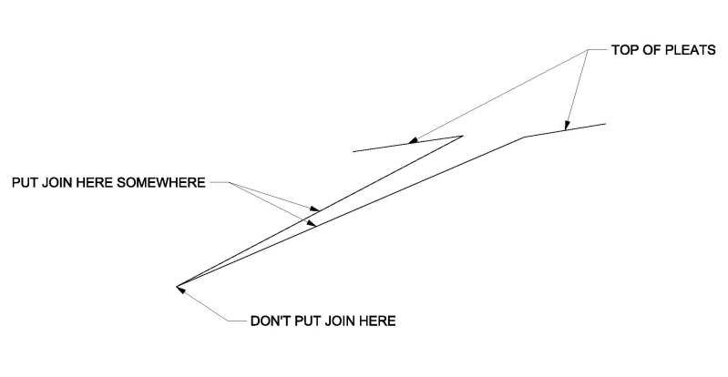

    Here's a few sketches I made in CAD. Keep in mind I'm used to drawing streets and stuff.
    This is how I would do a solid color contemporary kilt. Barb has pretty good instructions in her book for doing a traditional kilt.
    This first picture is looking from the bottom of the kilt up at the pleats. Notice, do not put the join at the inner fold or you'll have a large bulge after folding it over. I like to put it on the inside rather than the outside so it won't be seen when the pleats open up - if that makes any sense.
    The concept of not putting it on the inner fold is *I believe* what Barb was mentioning.

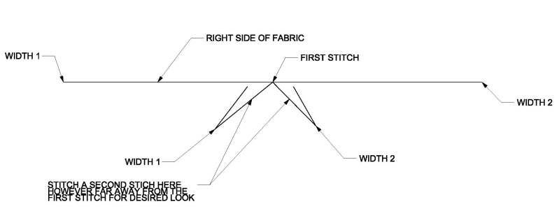

    This second photo shows the same thing, but this is pre-pleating. This image is rotated to where the top of the first image is now the right-hand side.
    This image shows the turned over join. Fold the outside edge in to prevent frayed edges from showing. The rotation is the same as the first picture.
    Hope these help and are clear. Again, this is just my way of doing things - may not be the correct or best way.

    As far as the placement of the join goes for a trad kilt, the following diagram illustrates the position so that the join is neither on the fold nor where it would show as the pleat opens up:
