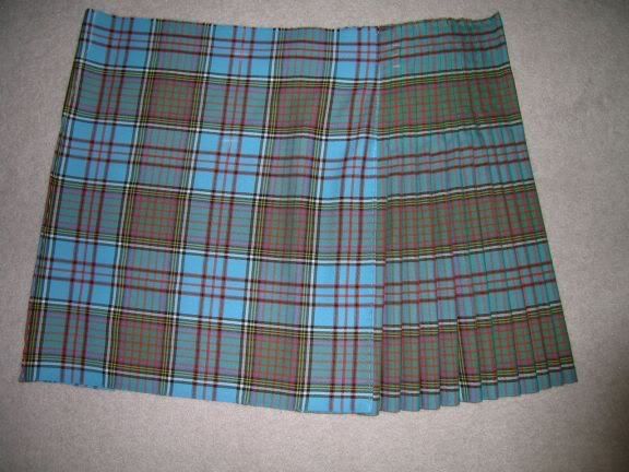

    Just a quick update...I now have 12 pleats done and need to join the two pieces together. I thought getting the pleats started was confusing...I've read over the join directions several times and I'm still unsure what I'm doing. Maybe if I read while I'm trying to do it it will make sense, instead of trying to visualize in my head. Here are a couple a pics:
    Full shot:
    Pleats:
    I had to hold it up against me last night, just to see it and I'm slightly scared it's about 1/2" - 1" too long. Held it up against my X-Marks and it confirmed it was longer. Not sure I want to go back now and make that adjustment.

    Quote Originally Posted by Kilted Taper
    I had a hard time wrapping my mind around that too. However, I eventually figured it out. My first one had a terrible join, as I just sewed the two ends together due to not having wrapped my mind around the concept. My second one had a proper join, and it's not too hard once you realize what's going on.
    Initially, though, you just sew the next pleat as though it were part of the same piece of material. Just line it up and sew, the same as you have the rest of the pleats. You'll come back later to stitch the excess fabric of the join together.

    So...if I understand you right...Just go ahead on with the second piece of tartan and join after I've finished all the pleats?
    if you haven't yet constructed the waist, can't you cut length from the top without removing pleats?
