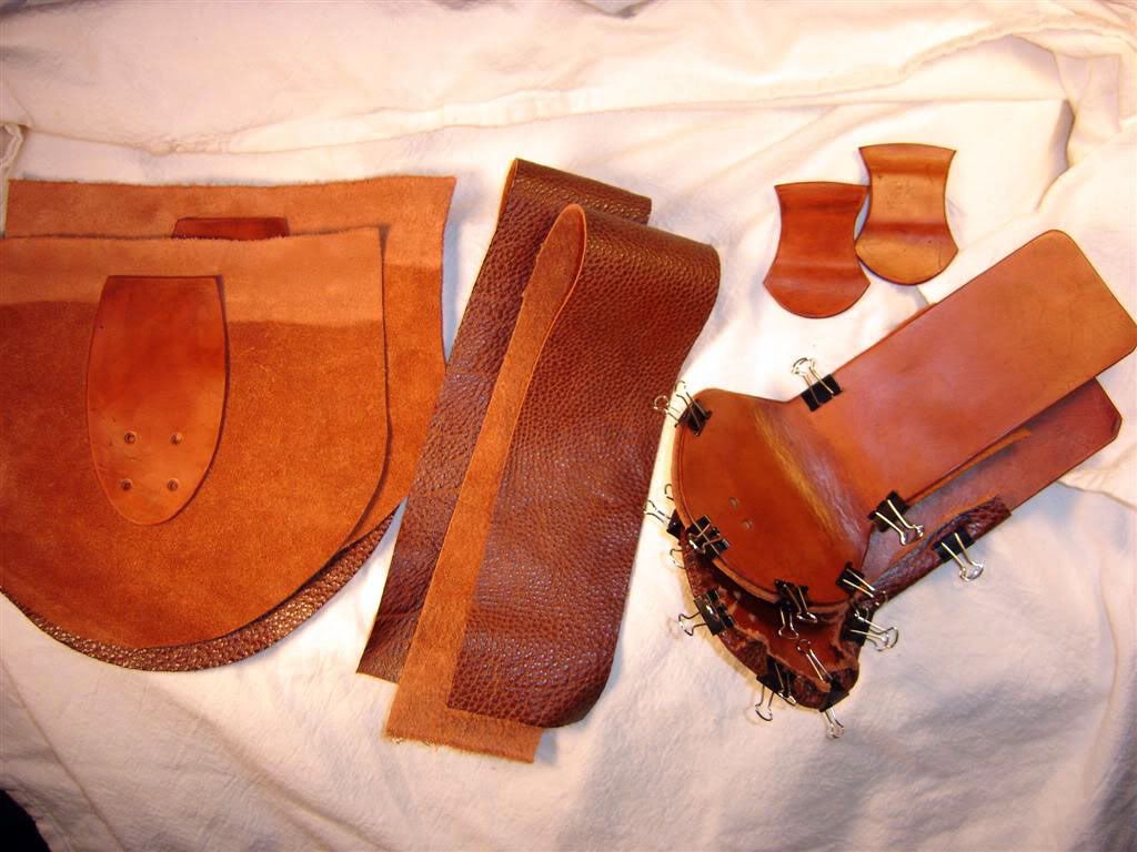

Here are the cutting for the new pieces. Reinforcing panels have been cut, dyed and are glued to their facings.
You can see that the top flaps are formed already. I do the shaping right after edging while the leather is still very wet and pliable. When the facings are glued on, they are glued with most of this shape maintained. They are then stretched on and clamped. This is important because if they were glued onto a flat flap it could cause extra stretching to the face panel in use.
Also of note, on the upper of the two flaps you'll see there is no leather to fully wrap the edge. Once the glue has fully set I will be lacing this edge. I really liked the effect on #2 - seen HERE, and will be doing a similar treatment with a slightly smaller braid (and obviously in a complimentary brown rather than black )

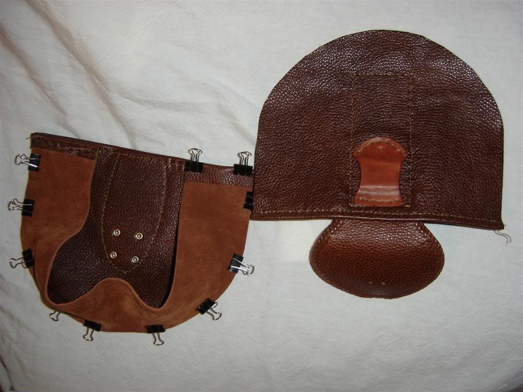

Thank you both. Here are a few updates from yesterday early evening.
The bag that has officially been designated #3 - panels attached to faces and awaiting the gusset.

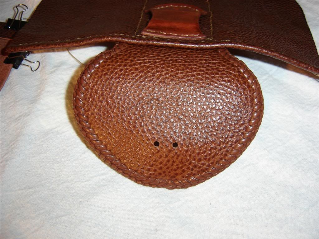

You can see that the top flap for #3 IS the one with the laced edge. Here's a detail shot.
I really like the laced edge. It does add a lot of time over the sewn leather edge, but I think the effect is quite nice. This has been laced in the same way as #2, with the flap in halves so the lace travels down toward the center from both sides. This also adds a bit of time, but I think it's time well spent.
Anybody have any thoughts on the laced edge? Too structured for a 'casual' bag?
I love the feel of the laced edge, and #4 may end up with the same treatment.
I'm a relatively new initiate to kilts and accessories; but IMHO, the laced edge takes it that step above the "mass produced" look. The little details are what give it that true hand made one of a kind appeal. I only wish I had the skills (and confidence) to do that kind of workmanship. And a hint of #5 yet to come has me waiting impatiently to see more of your work.
I agree, beautiful work.
Good Call! Certainly beats "Bring Out The Gimp" (ala Pulp Fiction)
4th June 10, 09:02 PM
#10
I have followed your previous sporran making threads and am enjoying this one also. I really like the idea of the braiding and as I said in a previous post it adds that little je ne sais quoi to your work. I don't think it is overbearing or ostentatious. From your comments you enjoy doing it and after all they are your creations. All the best with your endeavours
